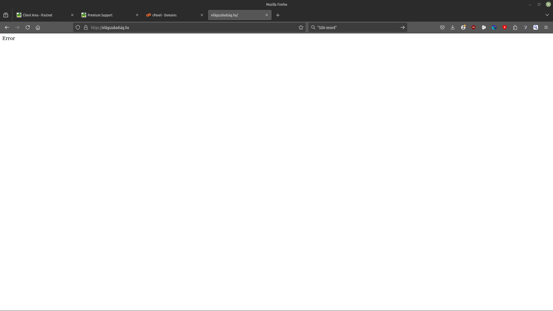

domain after deticking the share document root option. It worked fine for many years, but now it shows only "error".

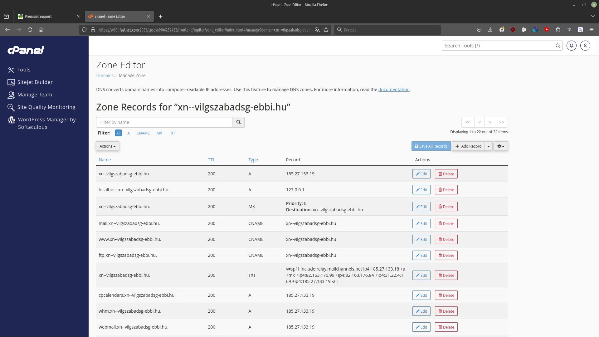

(See please: xn--vilagszabadsag-ebbi.hu.png and cPanel3_xn-vilagszabadsag-ebbi.hu)

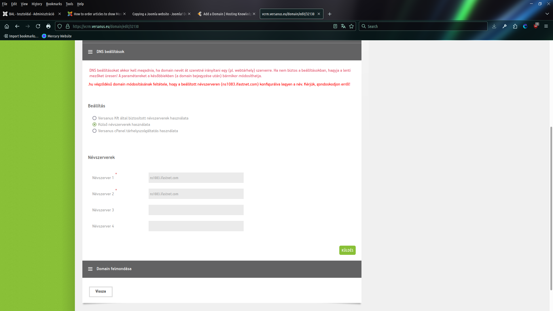

including deticking the share document root option. Then, as required, I entered the new nameserver data on versanus.eu and
punched send (KÜLDÉS). See: bal_versanus.png
After several futile attempts I protested and Versanus immediately tested it and informed me about the error:

Edit: your image shows the same nameserver listed twice, both ns1083.ifastnet.com.
Make sure you are using two separate nameservers, if you are continue reading.

Yes you are right. I indeed misspelled it in my ticket. The screenshot shows however, that in my domain index the correct version is present.
And since it has worked correctly before, the dilemma why it doesn't do now, still remains. Which leads me back to the SOA assumption.

I noticed that mistake myself yesterday and corrected it by adding both ns1083.ifastnet.com and ns2083.ifastnet.com
and I tried it again with my registrar. Maybe it works.
